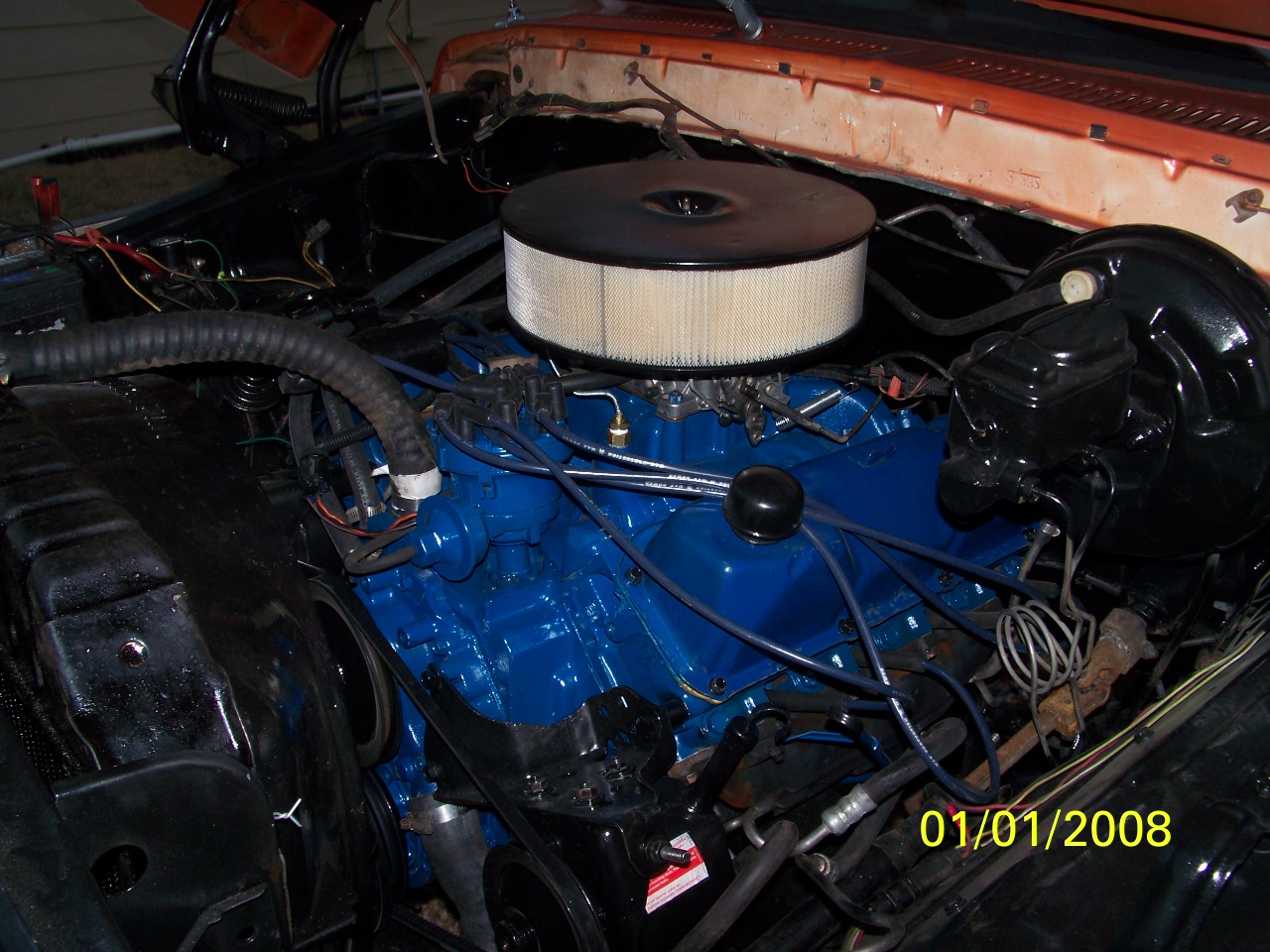

I , May Be On Wrong Trac Here, But I Just Experienced A Nearly Identical Issue, Bringing a 1977 f-250 back from colorado, ( It Stalled & i thought it locked up )So After I Had it towed home, we found a blown head gasket & cracked head, causing water in the cylinder, piston cant compress water, So truck would start , but wouldnt re-start until you let it sit for a while , i found 2 bent rods & 2 flat lifters , so long blocked it !!! , check for frothy oil ( water ) or oil in the radiator.Pics Are Before & after , this issue.

Also, Re-reading Your Post, Per Oil Pressure Issue !! , Possible Gummed Up Heads , Specifically ( Oil Drain Ports )?? , Causing Oil To Be Pumped Up Into Valve Covers & Slow Drain Back To Block , This Will Also Definately Cause A ( Stall / Sieze ) Issue . Keep in mind, i did not type this in my first reply, however, my engine never overheated ?? ( with a blown head gasket ) ???, I Am Guessing, This Was Due Too How Cold It Was Outside ? , all gauges seemed fine, she just abrubtly came to a stop , I Did Get Out & Pull The Oil Dipstick & It Showed " DRY ", so i assumed I Threw A Rod & Locked It Up, 2 Days After She Was Towed Home, & couldnt find a hole in the block,I Pulled Dipstick & it showed full ?? , i saw no oil in the water , or water in the oil, it was only , when i decided to longblock it & drained oil pan, that i saw the antifreeze drain out first , as it is heavier than oil !!!, my oil was never frothy.but i was blowing white smoke out the right bank exhaust & Constantly adding coolant to the radiator, hoping she would get me home, ( 82 Miles Short ).
