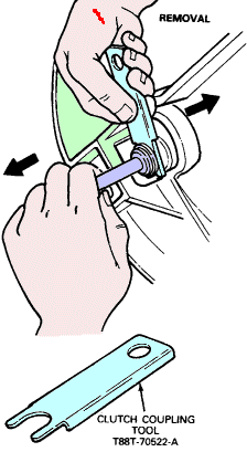

I found this illustration when i googled ford clutch coupling tool or somethin like that. The pic even shows the tool being used and arrows and all, but i just aint gettin it right. Maybe mine is too boogered up. When i try to push it "into" the slave and pull the line out, it doesn't go to far in before it wants to be gouged by the screwdriver. I ordered the tool off ebay for 4 bucks. I guess i can wait a couple days for that rather than accidentally destroyin the ring.
Am I gettin the theory right though? Push the white ring further into the reciever lookin part of the slave? Will that click open some lockin mechanizm? Sorry to come off so stupid in this one, I usually do pretty well, but this "quick release" thing is funkin me up.

Yes, slide up into slave cylinder and pull the line out, but since you've ordered the tool, you might want to wait and do it the right way. (dont want to mess anything up). Your theory, i think is right because judging by the pic, i thought the same thing.
