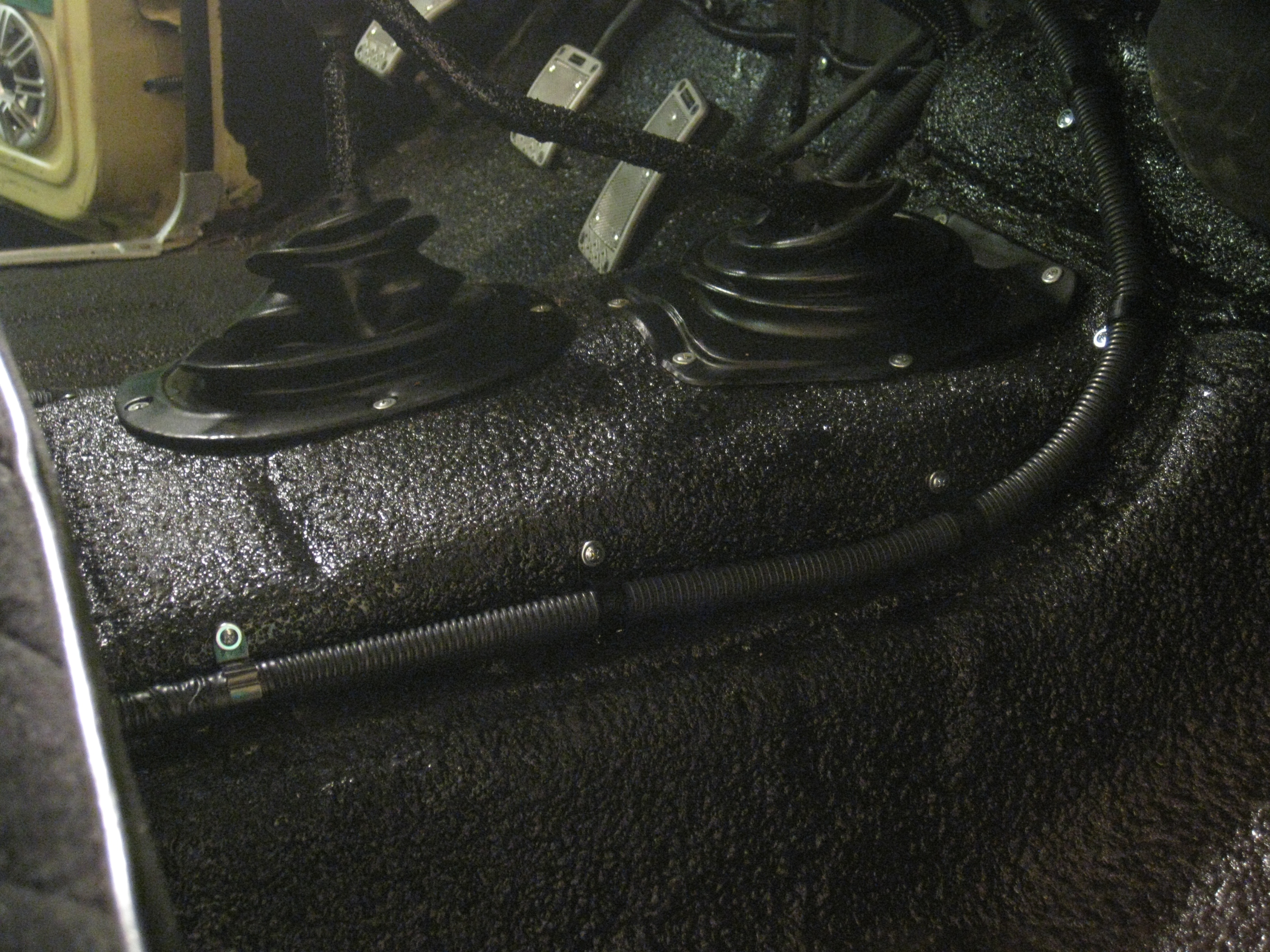

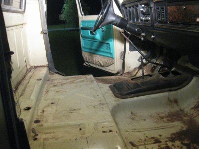

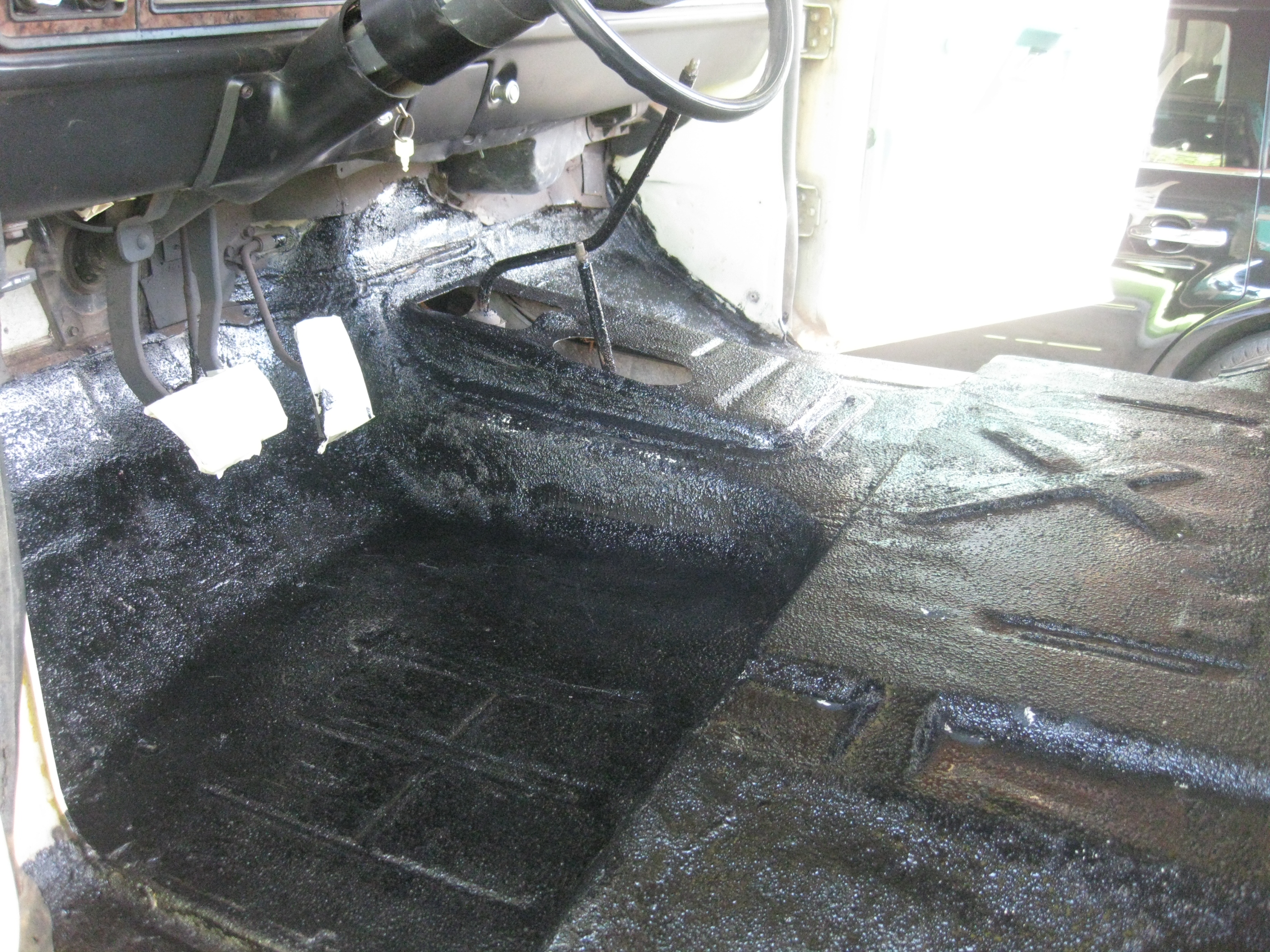

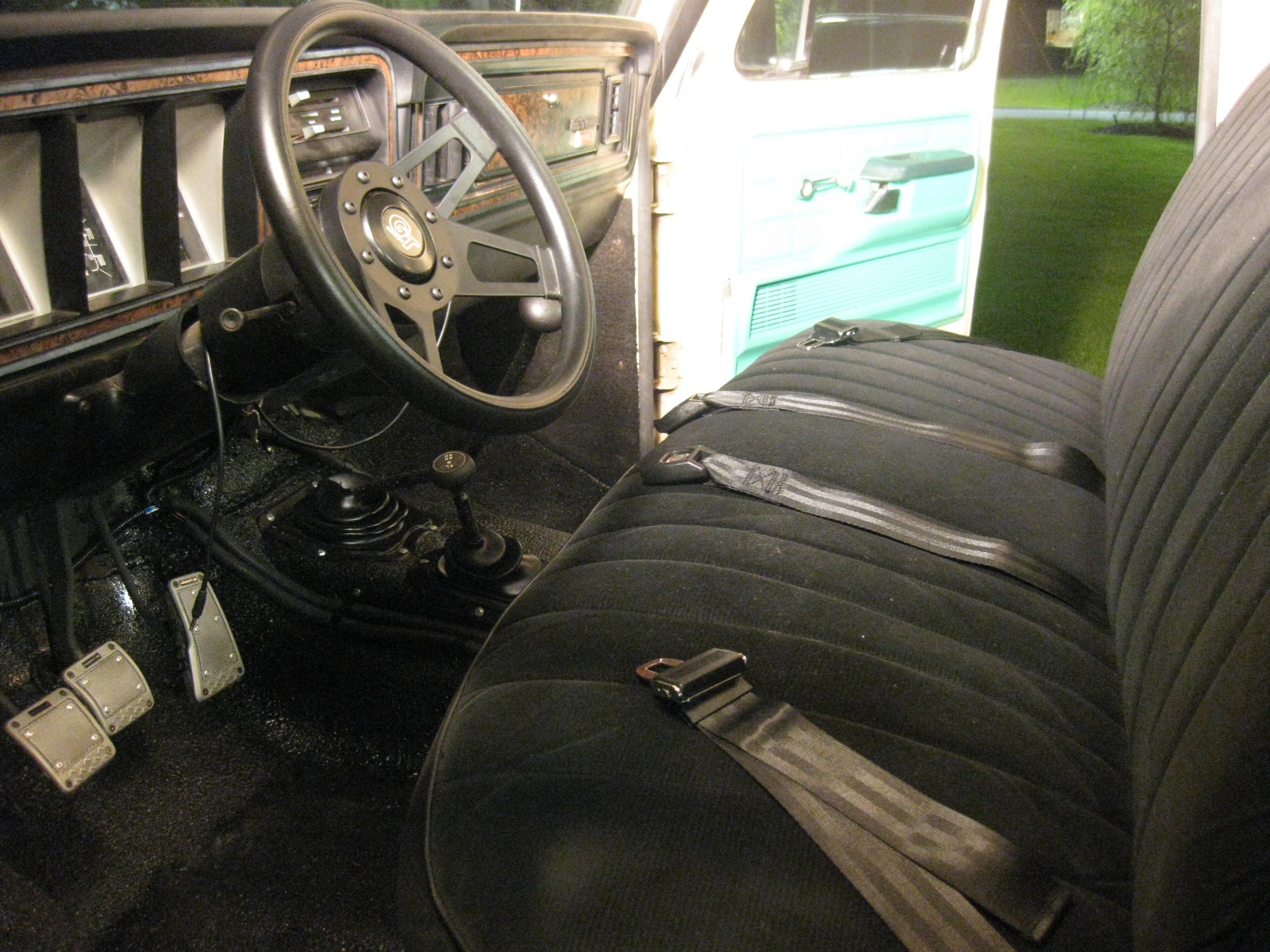

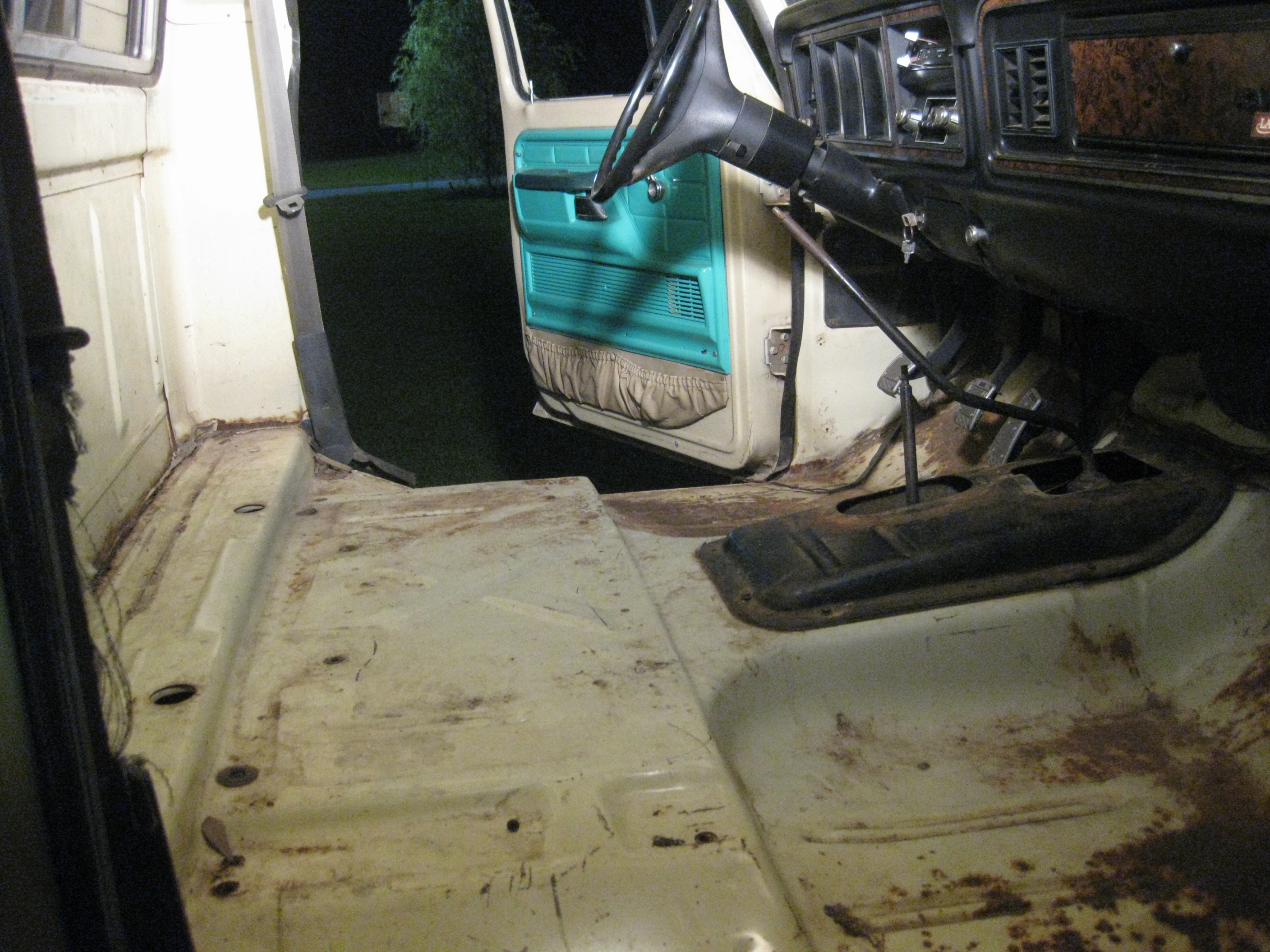

Never messed with the Carbon Fiber seats i just used Fabric Paint. Use a rust treatment on the floor and bondo to smooth everything out then Hurculiner the floor. Painted the rear wall with black Engine enamel. Came out great.
