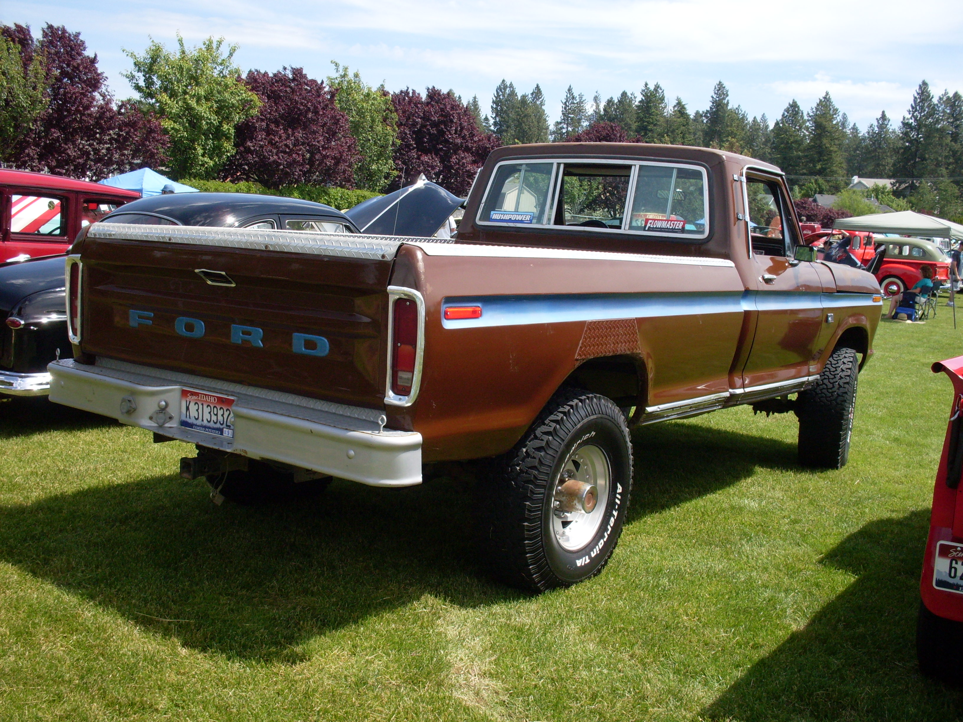

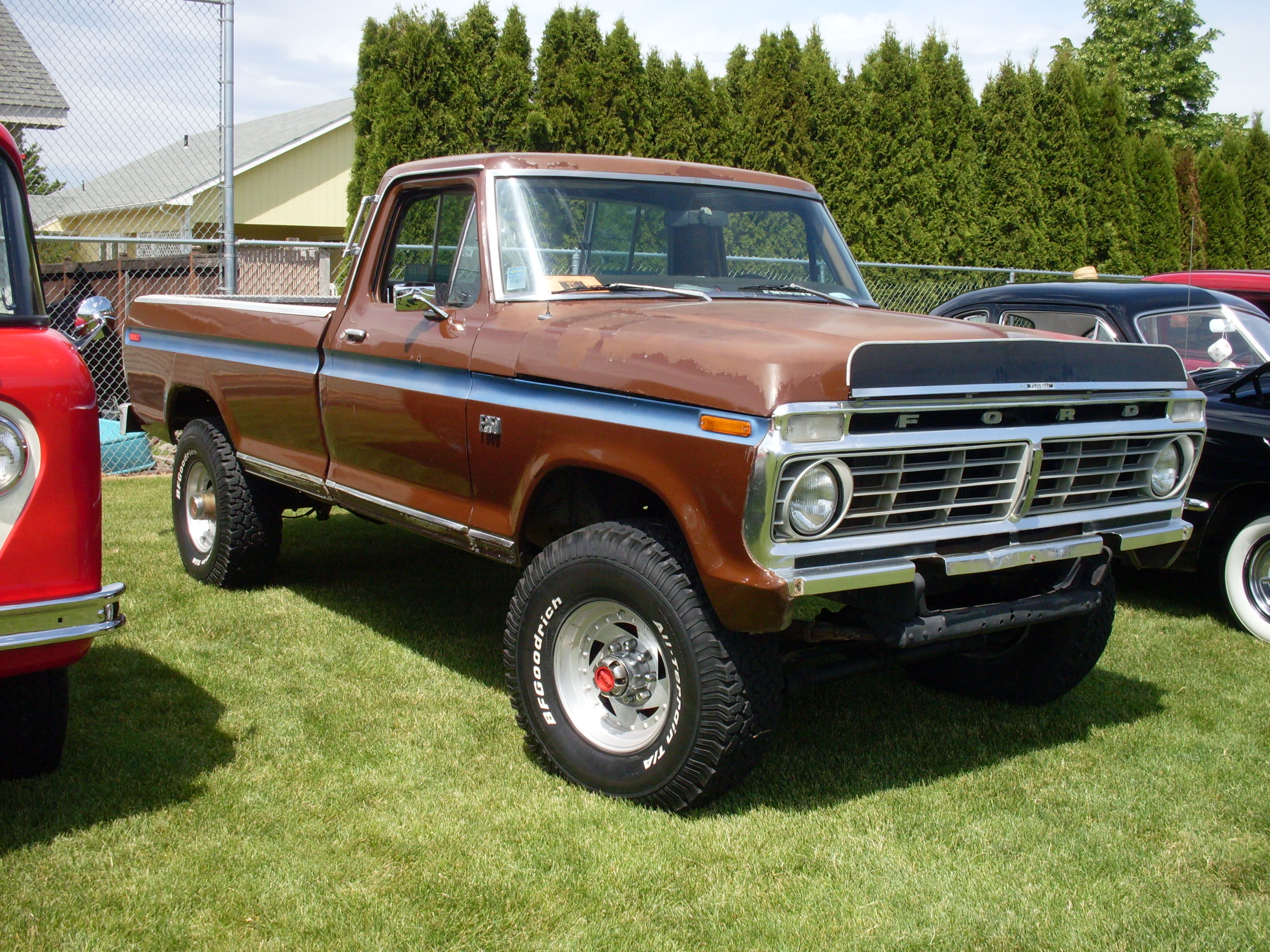

Why not just put a dana 60 under it and change out the steering and up-date everything,it looks like a nice truck and one someone would probably keep.......Wrenchhand from Arkansas 479-674-6162
