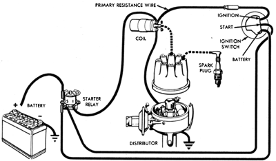

Breaker point type distributor circuit
5.A dwell meter reading of zero indicates that the breaker points are dirty or not closing and should be replaced or adjusted.

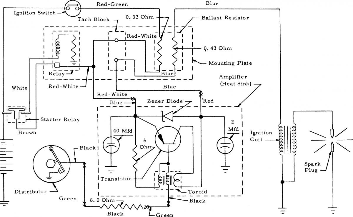

Breaker point type schematic circuit
3.To jump the ignition switch from under the hood, disconnect the ballast resistor-to-ignition switch wire (red with green chaser) at the ballast resistor. Then, connect a jumper from the positive battery terminal to the vacated ballast resistor blade terminal. If the resistor is not open, the ignition system will now be supplied with current. Check this provision before going further.
4.The only locations from which to get troubleshooting information are the tachometer block terminals, the ballast resistor terminals and the distributor primary bullet connector. By connecting a voltmeter and an ammeter at these points, with a well charged battery and the brown wire disconnected from the cold start relay, cranking amperages and voltages may be obtained that should correspond with the following chart.
