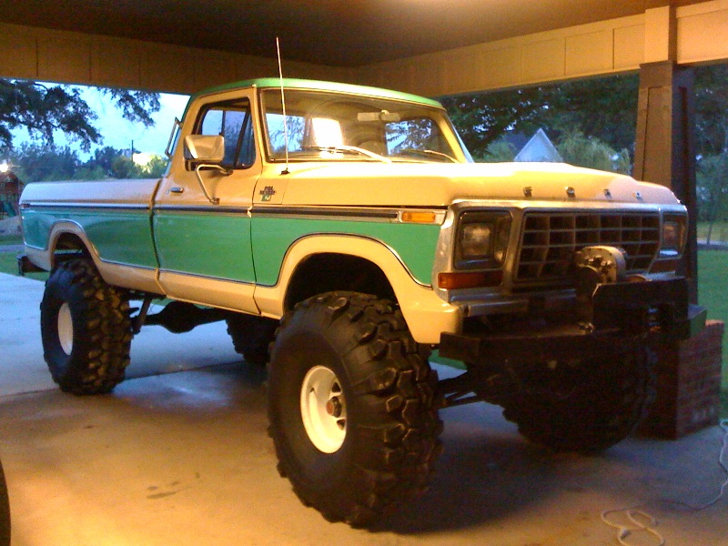

Just put 44 TSLs on my 78 F150. 400 Long Block, 4 speed, NP Case, Ford 9" Rear 4:10, Dana 44 Front 4:10. I was wondering if anyone has had any experience with 44 inch tires on Dana 44 axles? Of course i want to upgrade to a Dana 60 but I just wanted to feel you guys out first...

They snap shafts and explode u-joints. Drive easy and use four wheel drive just to get unstuck and you'll be alright for now. Plan on 60s front and rear for future builds. RKD.
