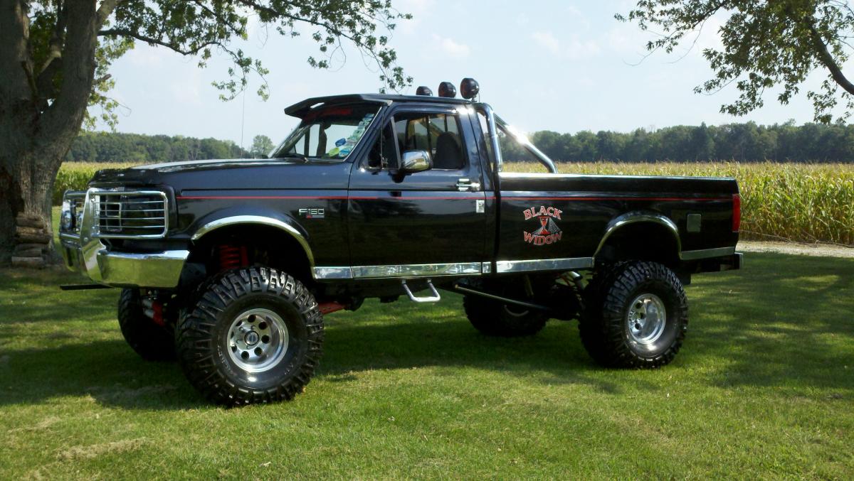

Just joined and looking for some advice! I have a 1995 f150 that I ripped out the 300 and built a mid 80's windsor for and i am running the factory 5speed manual and 1356 transfer case. I also was able to run my stock starter from the 300 straight six. It has 8" suspension lift and 3" body lift. I usually use it for shows and now love to take it to Michigan's Silver Lake Sand Dunes. I want to remove my 5speed and install the C6. Didn't know what i would need to make the swap happen. I will just put a floor shifter in, so i can keep my steering column. Will i have to switch starters, cross members, both drive shafts, Headers?
Already have the C6
ANY HELP OR ADVICE WOULD BE GREAT!
THANKS
