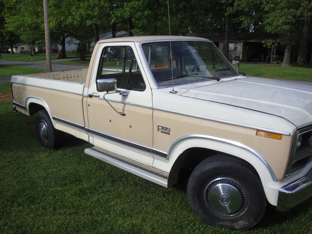

hi y'all i'm a newbie to this forum. I have a '75 bronco trail rig and am picking up a 1983 F-150 this weekend from my cousin and was wondering if it has a Windsor or a Modified
Thanks,
Jason
One way to tell is to look at thermostat housing. The Windsor should be mounted in front on intake and the M should be mounted on top of block in front of intake.
