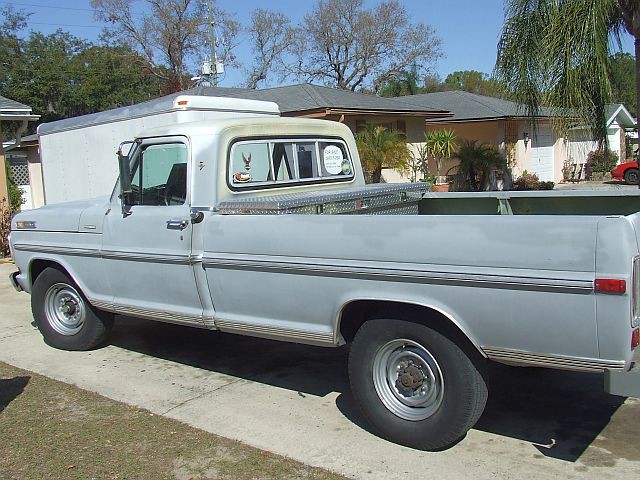

Welcome to the zone, good lookin original truck. Since you replaced everything you may want to think about cleaning the lines with air, they maybe clogged. the calipers maybe binding on mounting pins or brake shoes dragging on support plate. This maybe way off but there might be low engine vacuum if you have a booster on the truck.
